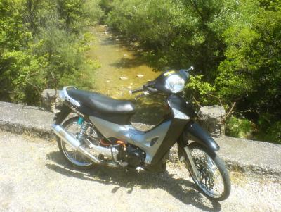

tsole 0 Αναφορά μηνύματος Δημοσιεύτηκε Ιούνιος 13 , 2008 Filoi mou eimai neo melos sto forum sas alla exw na pw oti exw ena innova 125 kai exw na pw oti kalitero se antoxes dynami kai aksiopistia i dynami tou den einai trelh alla gia ena megalo taksidi mporeis aneta na kaneis egw gia paradeigma exw paei apo naypakto pou eixa erthei diakopes mexri thn athina gemisa treis fores sto dromo kai pigena me 110kmh kata meso oro. twra exw fygei apo thn athina kai menw sto xwrio mou pou einai konta sth naypakto.opou exw to innova mou. to exw ftiaksei to mixanaki.tou exw balei eksatmisi takegawa ekkentroforo takegawa karbirater keihin 28mm kai eidei twra termatizei stis eytheis i tetarth pianei kofth sta 140 kmh me diplo atomo exw beltiwsei thn pisw anarthsh tou exw balei amortiser me azwto rithizomenes kai tis sklireneis oso thes exw beltiwsei ta frena tou kai mpros kai pisw kai thn epomenh ebdomada exw paraggeilei kylindro kai pistoni 56mm kai balbides takegawa me elathria pio sklira gia na antexoun ta strofarismata. otan allaksw ton kylindro meta exei seira hlektronikh takegawa gia na min pianei kofti kai mou kobei tin taxythta eykola. dld h 1h taxythta twra baraei kofti sta 50 xiliometra meta den tha pianei kofti apla tha baraei 60 kmh kai mporei kai parapanw dld tha afksisei tis strofes tou kinitira apo oti exw dei i deytera tha pigenei gyrw sta 100kmh i trith 130 kai i tetarth tha baraei peripou 150 me 160 xiliometra ayta exw na pw gia yperkibismo xwris na xaseis tin aksiopistia.apo ta 56mm kai panw meta xaneis tin aksiopistia alla exeis megales epidoseis.to innova me tin kefalh pou exei twra mporei na ftasei kai ta 72 xiliosta anoigma kilindrou alla oriaka isa isa me ta kalamia pou kratane thn kefalh alla ekei milame gia polla lefta den yparxei tetoia perptosi na ginei kati tetoio sto diko mou innova.oso gia to triksimo twn plastikwn poli aplo an kamia mera kathisete kai lisete ta plastika gemisteta me aytokoliti tainia pou bazoun stis portes to xeimona na min mpainei to kryo einai poli apotelesmatiko kai den trizoun katholou.oso gia to freno to pisw pou trizei to tampouro otan pate sto mixaniko sas na tou peite ti berga pou trabei to freno otan to patate na to balei anapoda sth panw pleyra dld na pianei anapoda i dynami etsi den tha trizei katholou .egw toulaxiston to eixa kanei alla twra den exw tetoia problimata giati exw balei pisw diskofreno.aytes einai oi plirofories mou panw sto thema ayto kai koitaxte kai to mixanaki mou na parete mia idea pws einai. Παράθεση Μοιράσου αυτό το μήνυμα Σύνδεσμος στο μήνυμα Μοιράσου σε άλλες ιστοσελίδες
